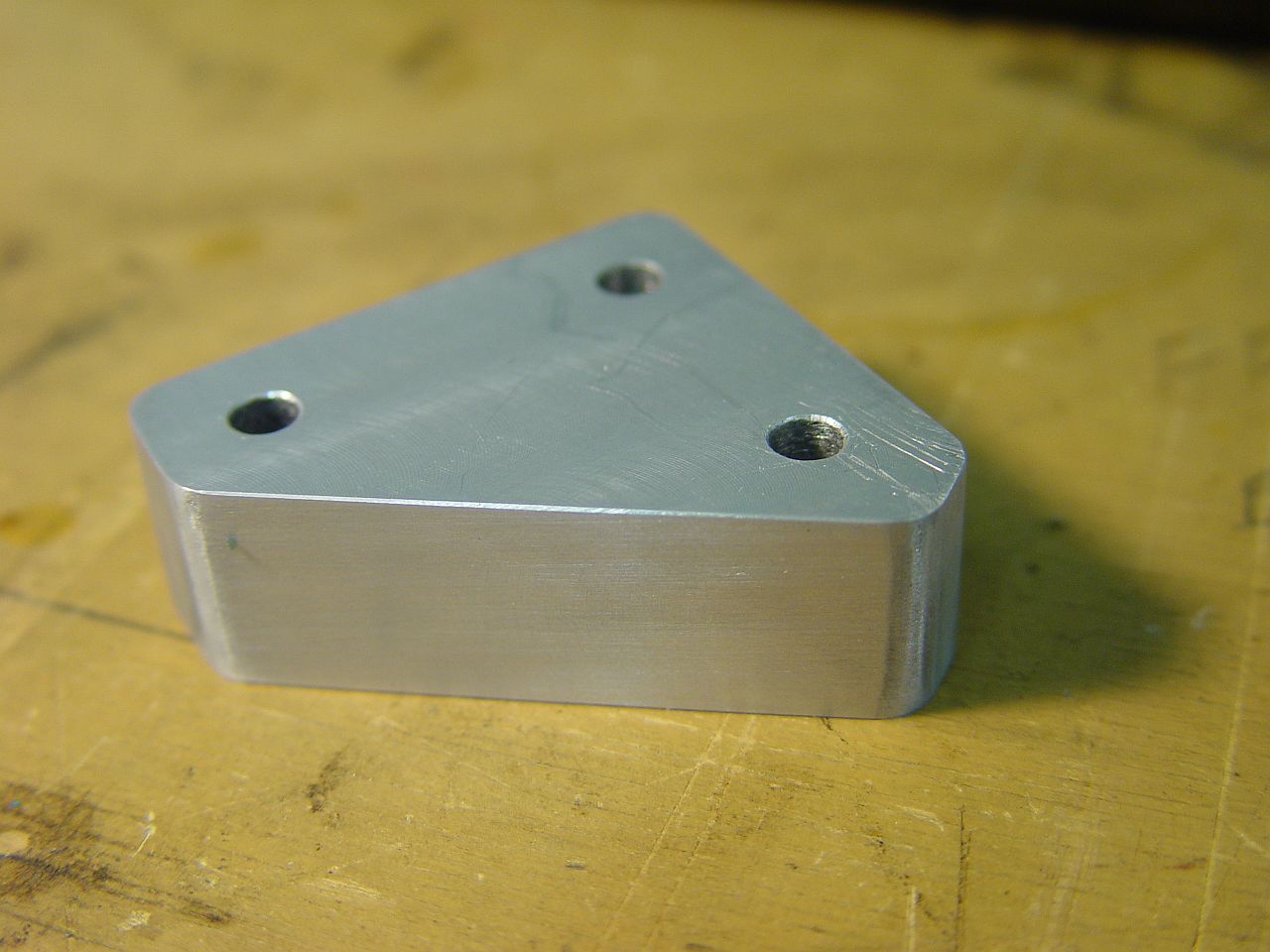

Well, I did about the same. To make it worse, the hole as drilled
resulted in the trailing edges being misaligned.
I ended up working with my Tech Counselor to weld over one hole, then
adding a aluminum block between the two horns. I was able to exactly
line up the elevators using the block. The block holds the alignment.
Then re-drilling the 2nd hole for the push rod end. My TC said that was
how it is done on the Pitts.
I think there are a number of ways to fix this including just going with
it the way it is as Vans recommends. But there's just something about
it involving the elevator...
I didn't fully document it but attached is a pic of the block which fits
between the two horns and is attached with 3 AN3 bolts.

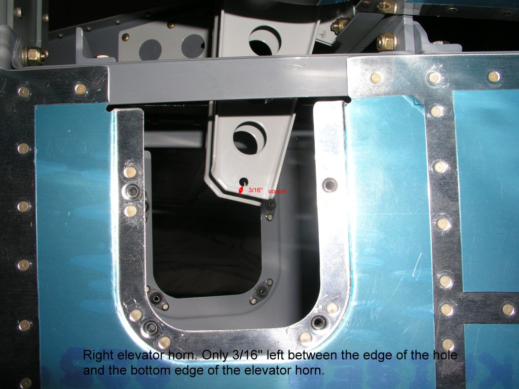

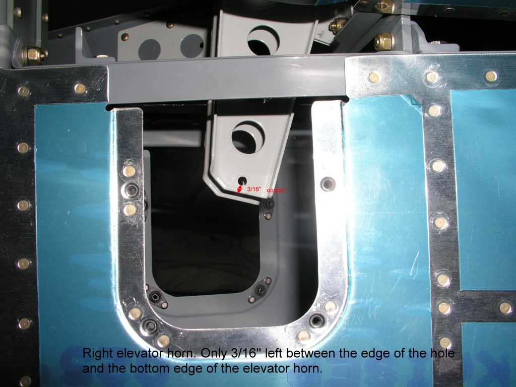

Lenny Iszak wrote:
Arrrghhh, missed this thread by about 20 minutes... drilled my elevator horns by the plans and screwed up... drilled the longer horn into the shorter one, just like Mike described:(
Called Van's, they told me that it will hold up as it is. I have 3/16 of steel from the hole to the edge of the metal. They said for peace of mind I could weld it and redrill.
Tim, If you could add this on your tips page it may save someone from doing the same thing.
There goes my swiss watch airplane... has anyone tried opening up the elevators and replacing the horns with new ones?

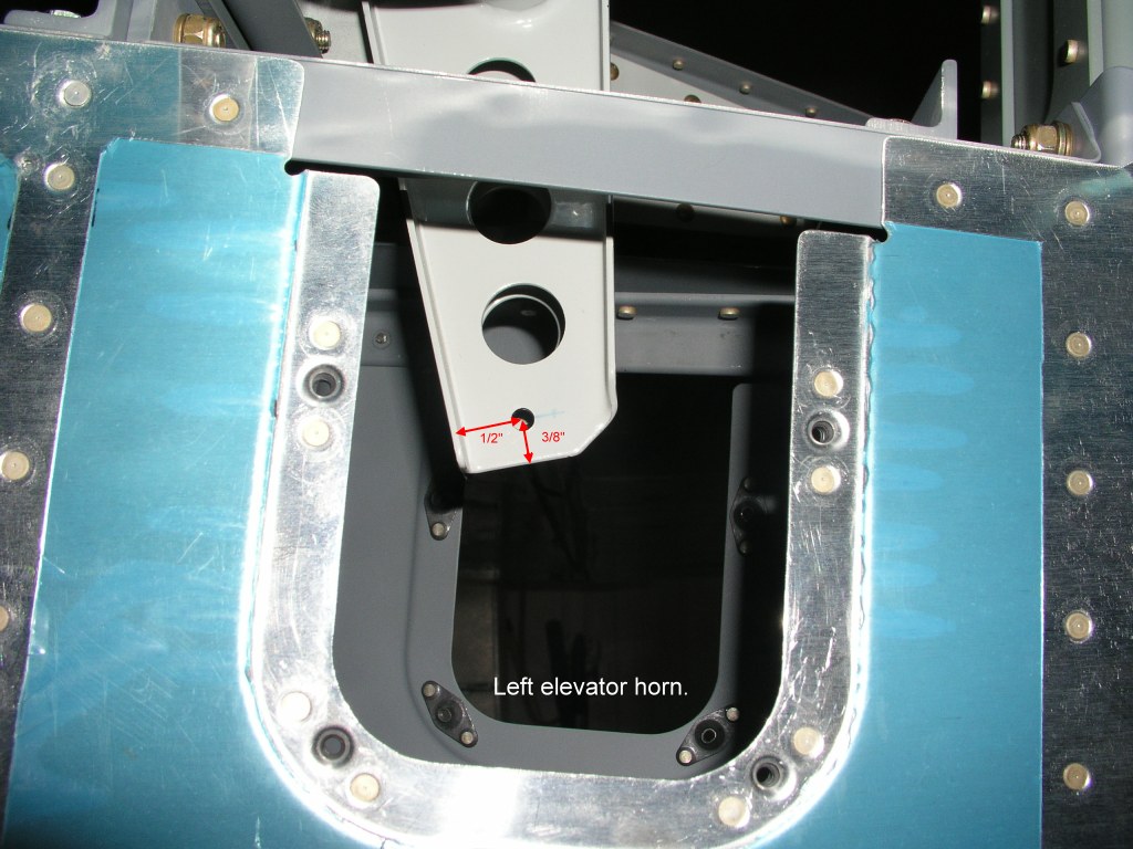

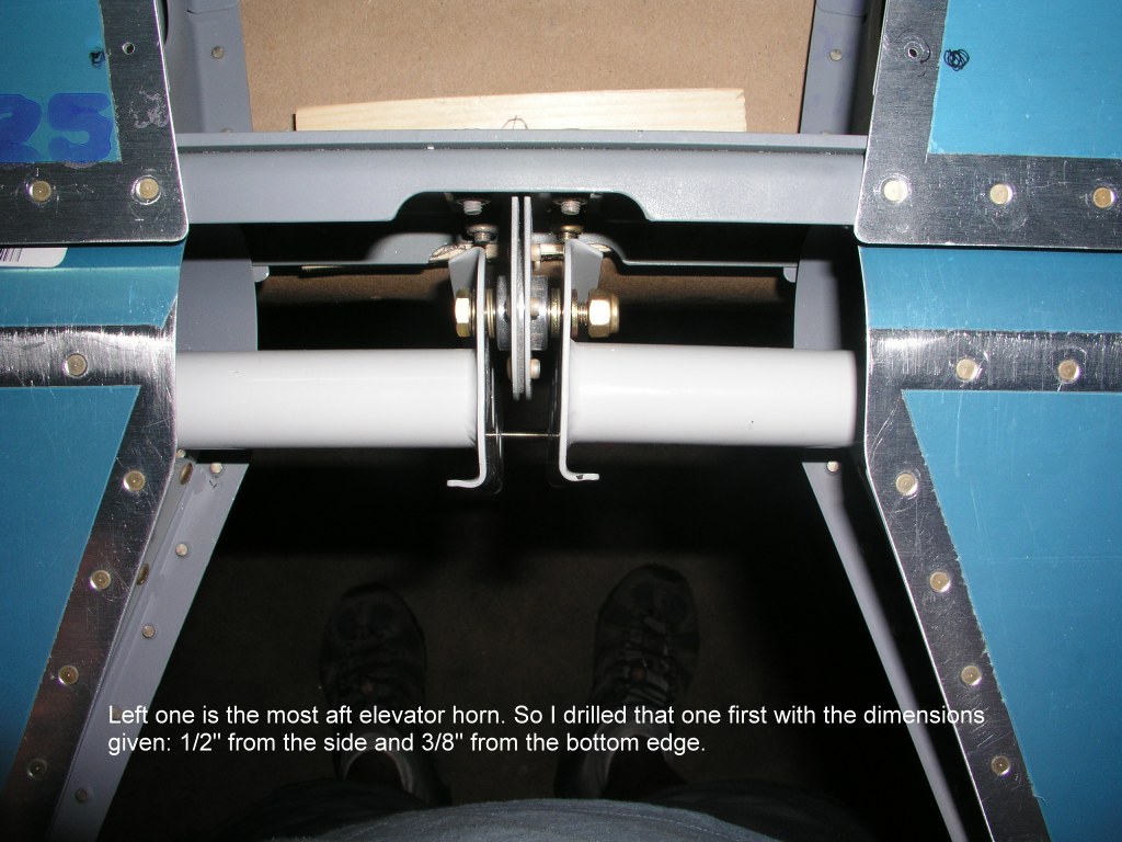

PostPosted: Tue May 27, 2008 5:51 pm    Post subject: Re: Elevators Reply with quote
Here are some pictures to illustrate the problem.
Lenny

PostPosted: Tue May 27, 2008 7:05 pm    Post subject: Elevators Reply with quote
Looks like mine and looks like you did a nice job too!. I really don't think
one need to worry too much as I figure the bolt will be on tight plus there
is the aft horn as well. Structurally, being Van's wasn't concerned, I trust
it should be fine.
Best of success reaching your comfort decision
Pascal

PostPosted: Tue May 27, 2008 8:04 pm    Post subject: Elevators Reply with quote
Lenny,
It's not a problem... The load is placed fore and aft...1/16" is not a big deal, it's not in shear, it's not going to make your watch stop in this case. Place a bolt in that hole and hang from it somehow....it ain't gonna fail. Later in the build you may get a chance to CUT some of that same material (Meager attempt to modify control cable bracket)...after you replace your band saw blade you'll understand how tough that material is. I've seen RV's with less clearance that what you have there...borrowed time? Maybe but most likely not. If you have ever felt the "feel" of a completed control hook up you will understand how smooth it feels and how well it moves. A good pull on the stick at 170kts is about 3 to 4 pounds of force, it is not that much strain and especially on 4130 steel. Remember there are only 6 aluminum pop rivets holding in your pushrod end into that aluminum tube....that horn is tough as nails. And...you can fall back on edge clearance...which is measured from the center of the hole, not the edge...your fine.
Rick (why do I ask for the flames) Sked

PostPosted: Wed May 28, 2008 6:39 am    Post subject: Re: Elevators Reply with quote
Thanks for putting me at ease. I was going to buy new horns and replace them. I'll sleep on it and decide later. For now i'm going to hook it all up.
The rivets in the pushrod are steel, MSP-42.
Lenny
