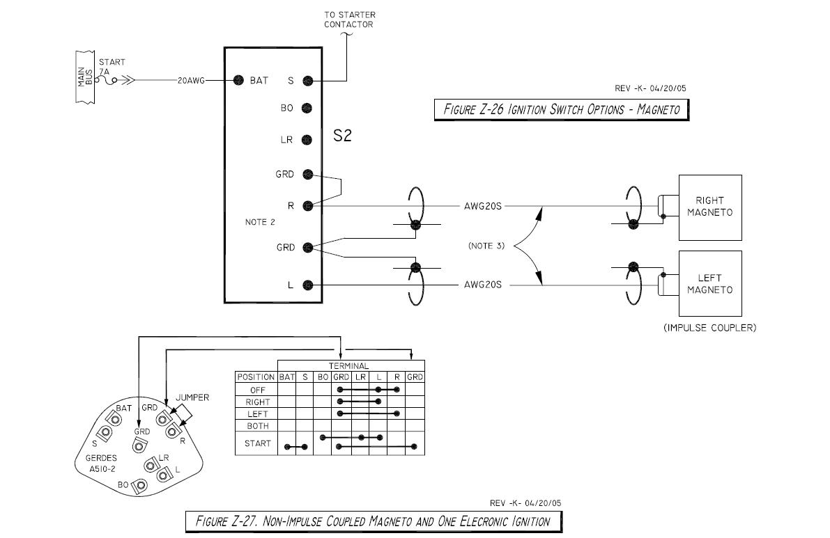

craig(at)craigandjean.com
PostPosted: Fri Sep 19, 2008 12:21 am    Post subject: Rotax 914 Reply with quote
Does it actually show the shield grounded at the switch or is the shield just connected to a terminal on the switch? The common off-left-right-both-start switch from Aircraft Spruce has terminals on it labeled “GRD” which the shields connect to. But they don’t actually connect to the metal frame of the switch case. They are just the terminals that the switch connects the P leads to when killing that half of the ignition. I’ve attached a snippet from diagram Z-27 in the AeroElectric update on page 30 at the link below. The table shows what actually happens inside the switch.
https://matronics.com/aeroelectric/articles/Rev11/AppZ_R11M.pdf
-- Craig

PostPosted: Fri Sep 19, 2008 8:07 am    Post subject: Rotax 914 Reply with quote
You’re spot on. The shield is only grounded at the switch end when the mag is turned off. Fig Z-11

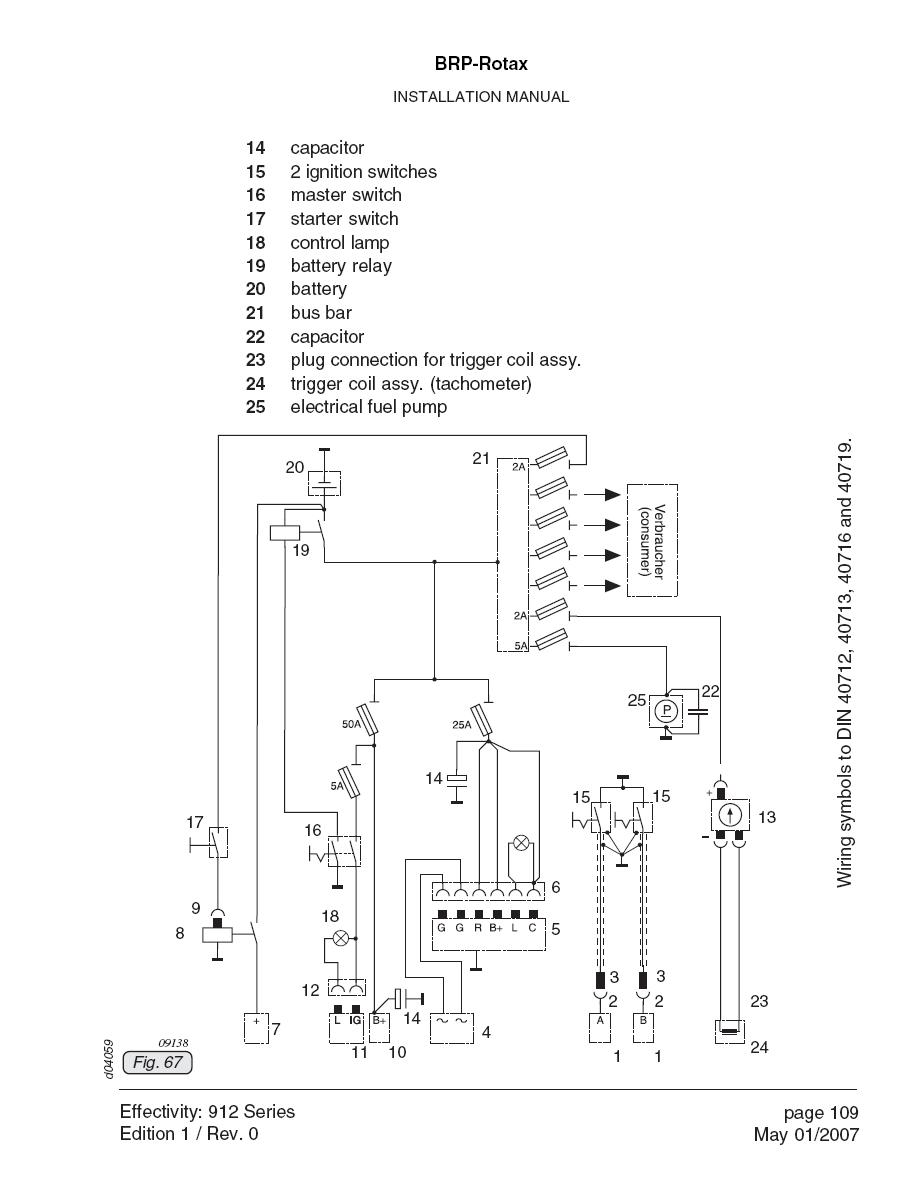

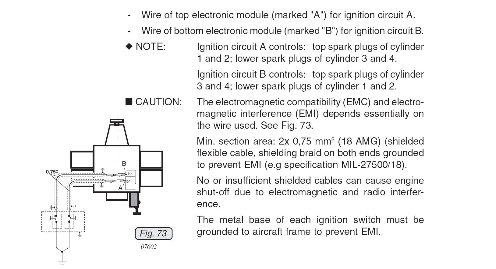

PostPosted: Fri Sep 19, 2008 1:14 pm    Post subject: Rotax 914 Reply with quote
Except that the Rotax manual shows a different set-up, with each end of the screen grounded, the switch body grounded and the centre-conductor of the shielded wire switched to a separate ground when the kill-switch is closed. The descriptions in the text of the manual confirm the indications of the diagram.
Hey, don't shoot the messenger; Ask Rotax how they got it "wrong"!

PostPosted: Fri Sep 19, 2008 1:43 pm    Post subject: Rotax 914 Reply with quote
Do you mean figures 67 and 73 from the installation manual (or the equivalent)? I’ve attached a copy of each. They certainly do appear to be grounding both ends of the shield in figure 73.
-- Craig

Yet the Rotax manual (later versions) show grounding of the shield at both ends, with a statement to the effect that their EMI compliance is not maintained otherwise.
Duncan Mcf.

It may be that with the conductor only grounded at one end the mag(s) may be cut off because of EMI within the cable... that’s the way I read it. However grounding at both ends will no doubt cause a great increase in RFI. In such a case I’d recommend a double shielded wire with the outside shield grounded at the engine end only. Sounds like a catch 22. Either the engine may shut itself down or you won’t be able to receive any thing on your radios...Com or nav.
One thing is for sure I’m going to get the chance to find out for sure in the very near future as I’m installing a 912 in my plane.
-- Craig

ignition by the book.
Worked flawlessly.
Some info here
http://contrails.free.fr/engine_rotax_mag_connect_en.php
Best regards,
Gilles
