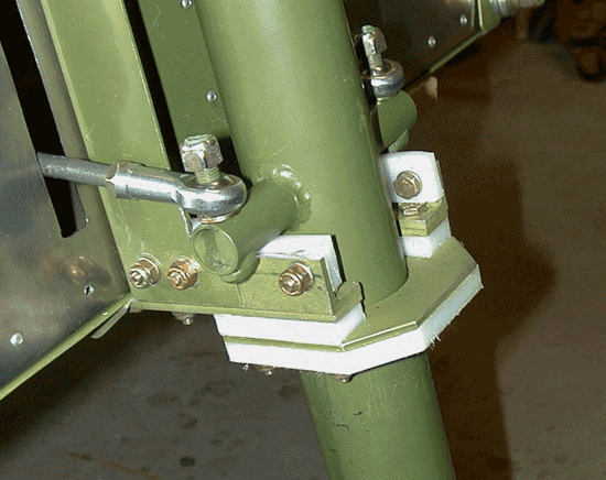

PostPosted: Tue Nov 11, 2008 5:43 pm    Post subject: CH701 nose wheel bearing Reply with quote
The attached photo is actually from an HD (Larry McFarland's?) but the
design on my 701 looks the same and I'll be adding the nylon. Basically add
nylon plates with V notches inside and parallel to the aluminum angle.
-- Craig

craig(at)craigandjean.com
PostPosted: Tue Nov 11, 2008 5:50 pm    Post subject: CH701 nose wheel bearing Reply with quote
Even the latest plans (7-L-1 dated 04/2006) show the V notch as bare
aluminum (7F8-6 dated 06/2005). I sent a picture in another message showing
how to add nylon V notches.
-- Craig
gus
Joined: 10 Nov 2008
Posts: 5
PostPosted: Wed Nov 12, 2008 5:43 pm    Post subject: Re: CH701 nose wheel bearing Reply with quote
The pictures look good. I have some 1/4" Nylatron sheet stock, that should fit well. Thanks for the pictures.

PostPosted: Mon Nov 17, 2008 6:40 am    Post subject: Re: CH701 nose wheel bearing Reply with quote
In order to get full bearing contact I'm considering lathe turning two bushings , these would require opening the 2" up to 2 1/4" on 7.F.8.4 ,7.F.8.5 and 7.F.7.4 . I would leave a flange on these bushings to allow bolting or riveting in place . They would also need a saw cut to allow them to fit over the nose gear strut assy. 7.L.1.1. My concern with the method in the photo is after the nylon wears a little , we will be back to metal on metal. What are your thoughts on this method ? Thanks Gus
