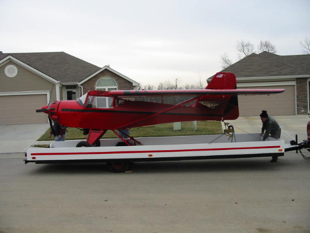

Attached is a picture of my classic 4 on her trailer. To steady the
vertical I use a plywood brace that slides over the top like a big rigid
sock. The elevator is secured in the full down position with a bungee in
the cabin

I have a curious question. Why do you choose to load the aircraft on the trailer tail
forward?
Is it because that makes it easier to load?
I could understand doing this if the main gear could be lower being behind the trailer
wheels but not on a flatbed trailer.

Kirk, and anyone else who trailers on a flatbed or knows the answer,
I notice in yours and several other pictures the tailwheel is raised so that
the wings and stabiliser are level, or I assume that is the reason. I
trailer mine with the tailwheel on the deck, specifically so that the wind
while travelling is exerting a downward pressure on the surfaces and
hopefully holding everything in place without flutter. I have never had
rubbing marks of the flaperons against the tail, which are held tight
against it, or any problems with the horizontal control surface which is all
the way down and not secured.
Some have mentioned fears of tailwheel spring damage but my Maule assembly
is very robust and never shown any problems. I secure the wheel itself to an
electric winch cable (used to lower the plane down the ramp) and ratchet
straps tightly to either side.
I would be nervous travelling with the arse up like your picture - can you
share your reasons? Also it looks like your rear inspection plates are off,
or is that a reflection in a shiny surface?

Paul - not sure who your question is directed at but I will give my reasons
for trailering tail-first on a flatbed.
First there are the aerodynamic reasons I just listed in another post - the
airflow while travelling will tend to keep the plane centered and pressed
downward rather than lifted by a gust. I have had straps come off at speed
due to my lazy or hurried tie-down but the plane has never shifted even when
not completely secured. Securing the tailwheel is most important so I have a
redundant system of winch cable and 2 angled straps, any 2 could fail and I
would not lose the plane. Also redundant straps keeping the wings inboard.
Second - I open the wings on the flatbed and push the plane to the ramp,
lower it down the ramp using the winch, then push and lift the tail off the
trailer manually. Same operation in reverse, very easy and quick.

kirkhull(at)kc.rr.com
PostPosted: Sat Jan 03, 2009 1:35 pm    Post subject: Trailering a Kitfox Reply with quote
The rear inspection plates are off. That is an old photo of the first trip
to the airport and everything was not buttoned up as I did a full inspection
before the first flight. As for the tail being up. That prevents excessive
air loads on the wings in the folded position. With the tail down on the
deck they will create a lot of down force

PostPosted: Sat Jan 03, 2009 4:43 pm    Post subject: Trailering a Kitfox Reply with quote
Why do you think "with the tail down on the deck it[they?] will create a lot
of down force"? The airfoil only works from leading edge to trailing edge,
in that position (trailering, tail down) the air pressure will just spill to
the sides and center and provide minimal force downward where you want it -
holding it on the flatbed. Seems to work for me, or are my physics wrong?
Lifting the tail can cause varying lift, down pressure, side pressures,
vibration, elevator flapping around, and other bad stuff. As others have
posted about "rubbing on the tail". No? Yes?

I think the reason for the tailwheel lift is so less fuel has to be drained
from the tanks before trailering.. It also eases folding and unfolding if
the wings track horizontally rather than down hill. At least that is why
the local trailer guy does it. He loads with the wings out and then folds
the wings, and infolds while on the trailer.
