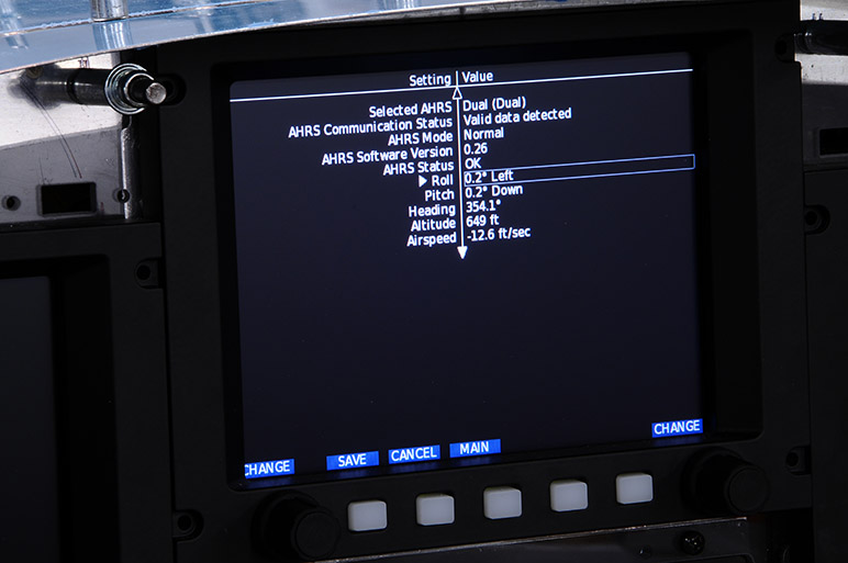

Thanks for the feedback. I also heard back from GRT tech support and they said that anything under .5 degrees is fine. I'm right around .2 degrees in both pitch and roll, so I guess that's close enough.
Matt
| | - The Matronics RV8-List Email Forum - | | | Use the List Feature Navigator to browse the many List utilities available such as the Email Subscriptions page, Archive Search & Download, 7-Day Browse, Chat, FAQ, Photoshare, and much more:
http://www.matronics.com/Navigator?RV8-List |
| Description: |
| Pitch and Roll at .2 Degrees |
