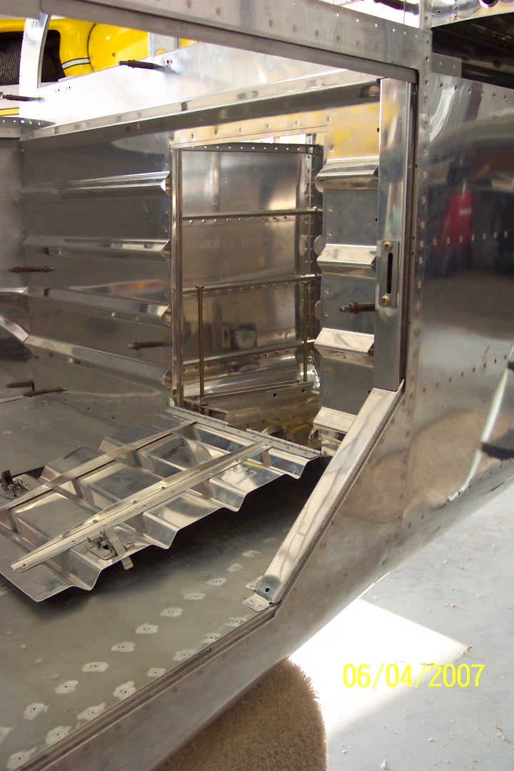

I saw a post at one time where one of you made an access panel in the back baggage wall and am trying to locate the person that did that and see his pictures of the panel. I just finished my second conditional and made up my mind I've got to do something that make it easier for that back area access. Tons of screws to remove and undoing the seat belts etc. I also have my oxygen tank attached to the back baggage wall area, which I took the idea from Randy's web site.
So whoever that was I hope you can post your idea so I can copy you.

Wayne, here's a link to a photo album, that shows how I did mine, I
copied the idea from Robin Marks. just follow the links to next image
there should be about 20 pics that show the process.

Ck Robin Marks site. I copied his

Wayne,I did that mod to the rear baggage wall. I'll get a couple of photos tomorrow and e-mail them to you. I am not sure how to post photos. - will also put a write-up about it on my blog. Here is the link wwwmkitaircraftmods.comDaveFitting the door hardware.

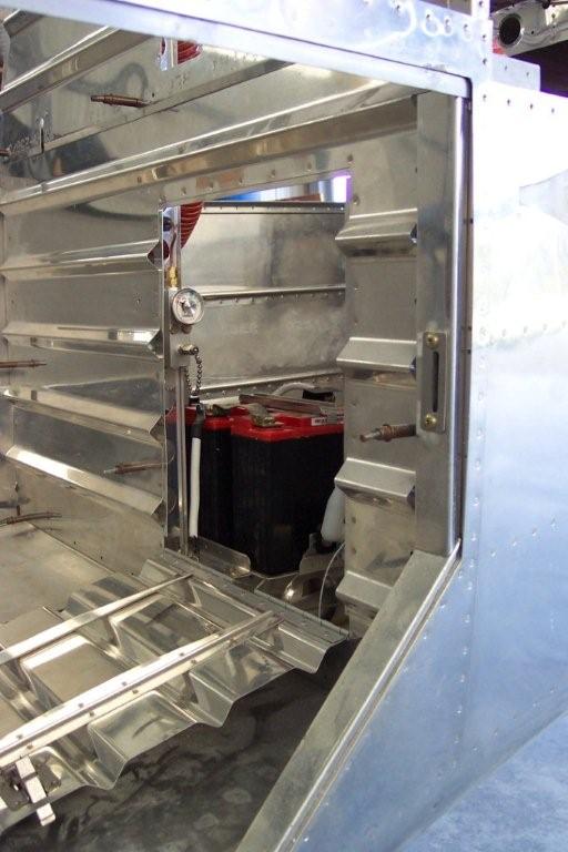

I'd be a little cautious about cutting the panel as it may affect
strength of the bulkhead as designed by Van's.
Might check with them before shortcutting potential strength design.
grumpy

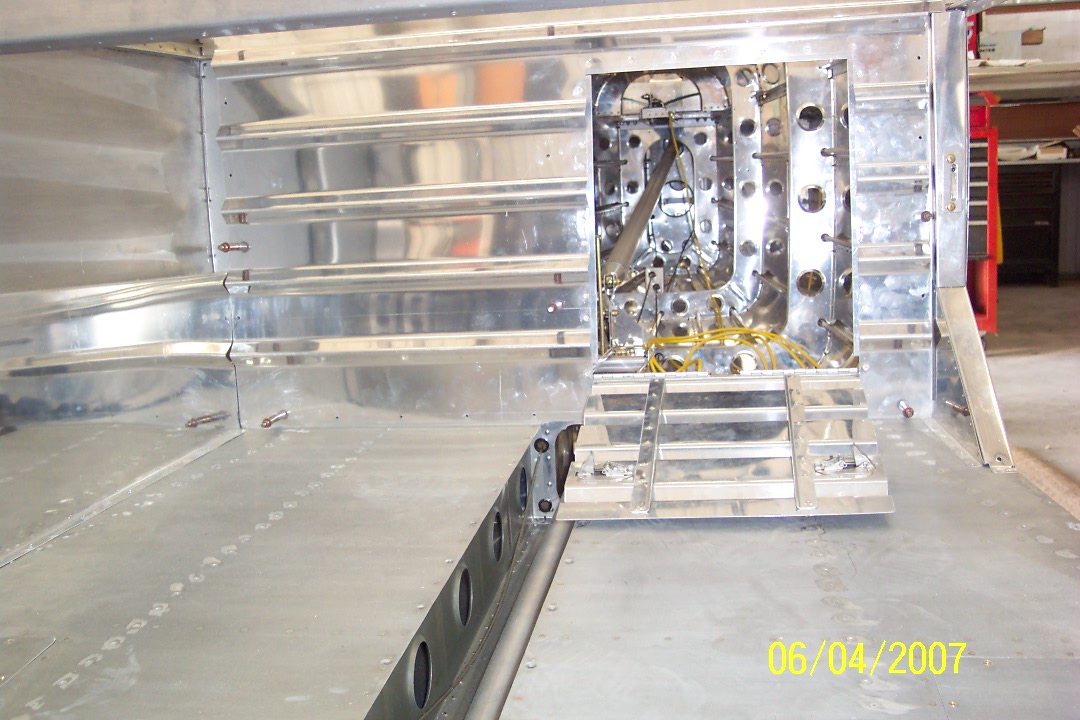

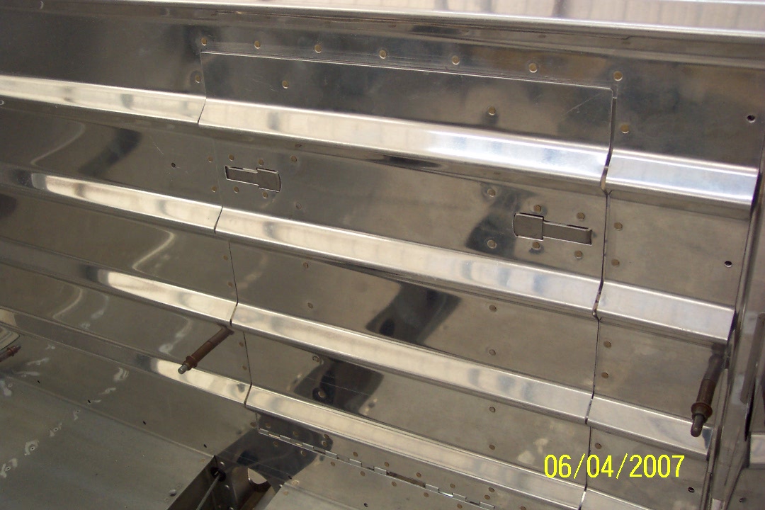

Wayne, I think that is my build. My only regret is that’s it’s not even larger or add a second one. Tremendous for Battery access etc.. My O2 filler connect is also located there.
On important component. Use a split hinge pin to allow for easy removal.
A slightly different design is to have the door hinge at the top and hold it up by a simple Velcro strap or the like.
Robin

Actually, I've heard many times that it is a structural wall,
and that you can't fly without it, and if you alter the back
wall you want to make sure it's sufficiently beefed up to
give it back it's structural-ness. So, if you cut into it,
just plan ahead to make sure you do all you need to make it
just as strong again. Contacting Vans on that one wouldn't
be a bad idea.
be a bad idea.
Tim Olson - RV-10 N104CD

--> RV10-List message posted by: Miller John <gengrumpy(at)aol.com (gengrumpy(at)aol.com)>
I'd be a little cautious about cutting the panel as it may affect strength of the bulkhead as designed by Van's.
grumpy

Listen carefully to what Tim and Grumpy are saying. I'll be more blunt. The baggage bulkhead IS a structural component and is necessary for asymmetrical HS loading/twisting moments. (Sound familiar? Check the tail SB). That is the reason for the corrugations and all of the screws. It must not be compromised for ease of access. I do not like what I see in the photos.

Yes, Vans will more than discourage any modification of the rear baggage
bulkhead. However, looking at the pictures of Deems and Waynes door, I
think if you were to use #4 rivets along the supporting frame not #3's, AND
used the same hinge program at the bottom but used ( 9 qty.) #8 nutplates
and screws - 3, on each side as well as 3 along the top, your strength would
be there. Yes, you still have 9 screws to remove (with a screw gun this is
only minutes) but still way less than the 25 - 30 it takes to remove the
entire bulkhead.
Which now leads to the next question of if this modified portion of the
bulkhead is now stronger than the other side of the bulkhead how does that
effect the integrity of the part as designed? Just a question to ponder -
no replys needed....

of a couple of female terminals that paralleled the battery. This
allowed me to directly monitor the battery state (by multimeter) both on
the ground and in flight, recharge the battery, and supplement the
battery with a DC power supply for avionics testing/setup; without
having to remove the bulkhead. I would do it again in an instant.
