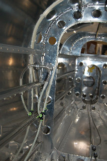

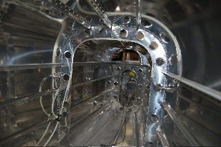

I've got the Clevelnd ports interfaced to Stein's static tubing with
1/4" id clear tubing from the aviation department of my True Value
hardware store. It wasn't too hard to mount and support it all in a
way that will not pinch itself off... I don't have any pics, but could
take some in the next day or two if that would be helpful.

Hey Jeff,
Pictures would be great. Thanks in advance.

PostPosted: Tue Jul 21, 2009 9:12 am    Post subject: static lines Reply with quote
I think this shows it...
Jeff Carpenter

PostPosted: Tue Jul 21, 2009 9:51 am    Post subject: static lines Reply with quote
Just a thought, but you might want to relocate the T on your static
line so that it is higher than the port so that you will drain any
water out of the static port rather than down into the line towards
the avionics...
James

jeff(at)westcottpress.com
PostPosted: Tue Jul 21, 2009 10:24 am    Post subject: static lines Reply with quote
Thanks James... I will.

jim(at)CombsFive.Com
PostPosted: Tue Jul 21, 2009 12:19 pm    Post subject: static lines Reply with quote
Jeff,You might want to re-run those static lines. The "T" should be as high as possible so that water will run out of the lines not into them and collect / freeze.Jim CombsN312F Flying - 90 hours--------------------------------------------------------I think this shows it...Jeff Carpenter40304On Jul 13, 2009, at 10:42 AM, Lew Gallagher wrote:> --> RV10-List message posted by: "Lew Gallagher" <lewgall(at)charter.net>>> Hey Jeff,>> Pictures would be great. Thanks in advance.>> Later, - Lew>> --------> non-pilot> crazy about building> NOW OFICIALLY BUILDER #40549> Painting done!> On with wiring and avionics.>>>>> Read this topic online here:>> http://forums.matronics.com/viewtopic.php?p 52811#252811>>>>>>>>>> [quote][b]
