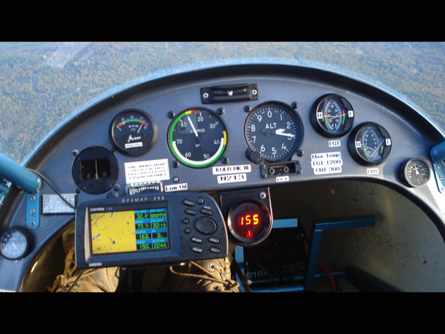

PostPosted: Sun Oct 04, 2009 4:24 am    Post subject: Heel brakes or ??? Reply with quote
It really doesn't make a difference to me Heal or Toe Brakes when I had small tires on the brakes worked ok now I have bigger tires on the brakes dont seem to work as well, I made a change and got a reaction, now I have to make another change to get the reaction I am looking for
Heres a Few pic's Flying around Maine in a Kolb MK3C See attachements

elleryweld(at)aol.com
PostPosted: Sun Oct 04, 2009 6:17 am    Post subject: Heel Brakes or ??? Reply with quote
no thats a digital Temp guage
Ellery
