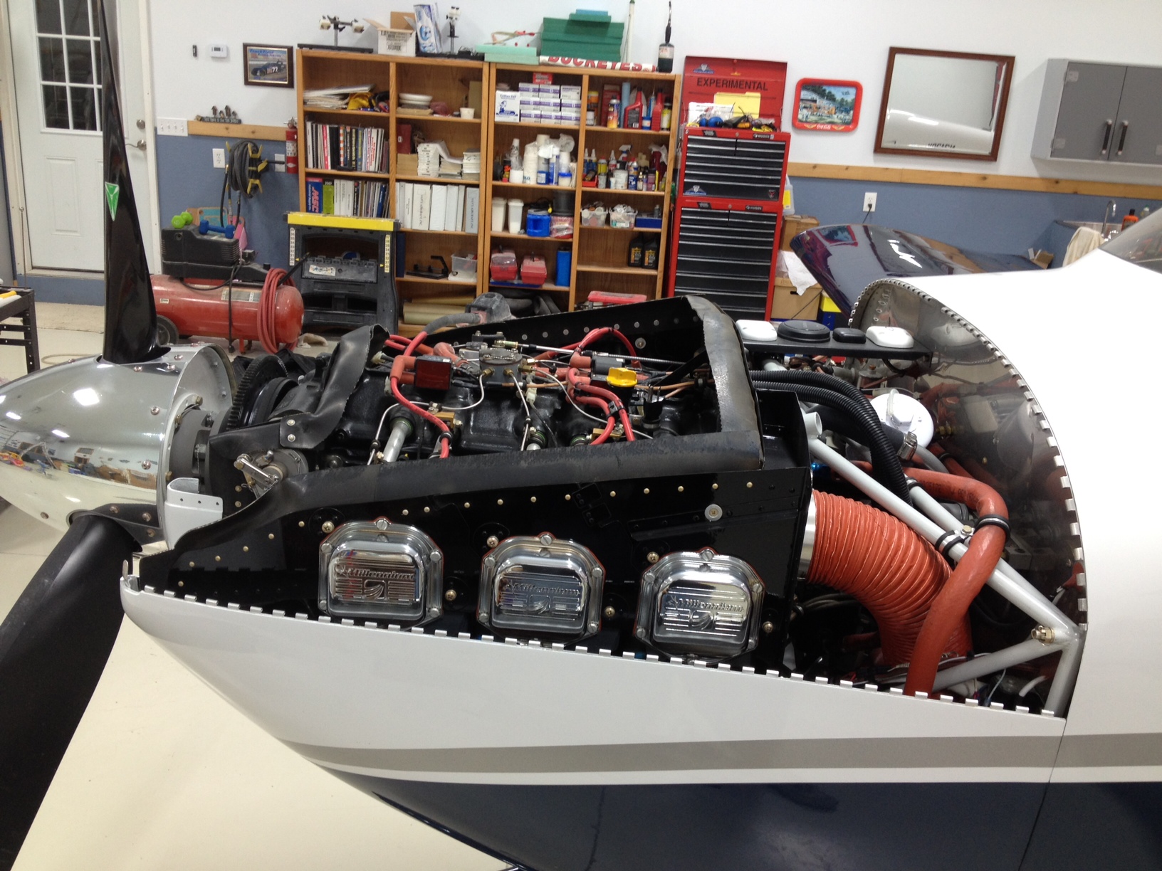

Here's a couple of baffling tips worth what they cost.
Those dad gum steel pop rivets are the most strenuous project of all. I grunted more on those bad boys than installing the main gear legs.
I finally got smart and breaker bar'd my hand squeezer.
Also, I found that if I drilled the holes for those rivets at 31 instead of 30 (drill size), they secured better and didn't pull ever pull through.

A pneumatic squeezer (even the cheap Harbor Freight one) makes those baffle rivets way easy. JAY ROWE

I have one that works great for aluminum rivets but wouldn't budge those steel ones.

I used soft AN4 rivets and 1/8" aluminum washers. Looks really nice, holds great, and super easy to drill out if needed....

You were right and I was wrong. My squeezer had sat for a bit and wasn't properly primed. Once I dialed it in, it pulled those rivets with no trouble.
