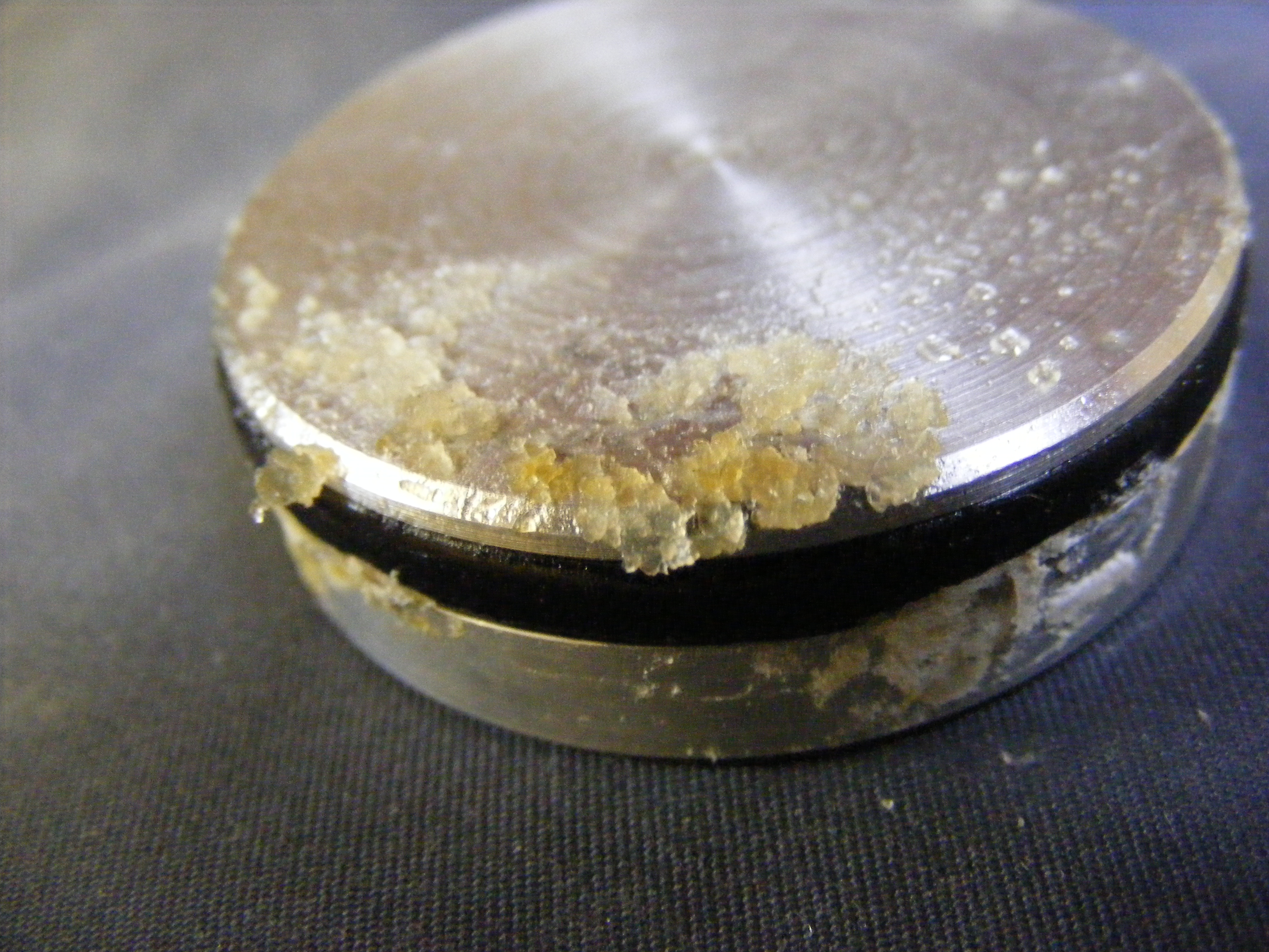

I have recently worked on two XS Mono kits that have been well stored (warm and dry) for the last twelve years.
As a matter of course, I strip and inspect all components before assembling and on both I found that the brake slave cylinder pistons were stuck fast.
Using a compressed air line to pop them out, I discovered that both were covered in a glutinous substance (see Picture).
I am not sure what this is but would hazard a guess that it is old hydraulic fluid that would have been used to lubricate the piston during manufacture and being hygroscopic, has absorbed water over the years and degraded.
I would suggest dismantling all of your hydraulic components and carefully cleaning and reassembling with fresh hydraulic fluid. I pretty sure that you will then be able to bleed the system as described by others.
As an aside, I am certain that this is the cause of high brake disc and pad wear with associated hot discs that other mono pilots have complained about over the years.
If you intend to keep the aircraft and have a desire to reduce subsequent maintenance, I would also highly recommend having all the components anodised. I have done this to mine and can send picture offline if you are interested.

I had an experience similar to Nigel. My unit had been stored for a similar time.
After soaking in various fluids for several weeks, using heat and compressed air to no avail, I ¨borrowed¨ the hand pump from a hydraulic press which finally shifted to piston.
The piston was dry and so badly corroded I turned up a new one, also adding concentric grooves to the rear face to allow fluid easier access to the piston when fully retracted. The bore of the cylinder I was able to salvage.
