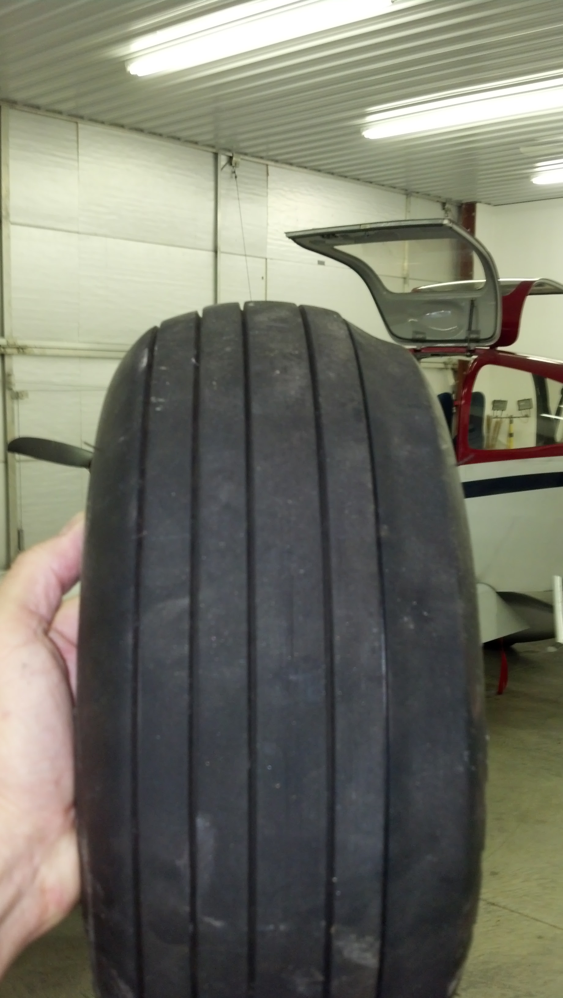

PostPosted: Wed Feb 12, 2014 1:18 am    Post subject: rapco pads Reply with quote
The disc looks fine
This was my first set of rapcos installed in may
Wll send the pictures to rapco.
This was the left side
If it wasn't for the caliber leaking i won't have found this. Brakes worked fine.
Didn't check the right side.
Will probably wait to annual in may.
Alan

It actually could be the leaky caliper that caused them to look so bad. It'll be interesting to hear or see pictures of the other side that didn't have that issue when you finally wear them out.
Rapco's done I'm sure 10's of thousands of pads for many models for many years and in many cases I'm sure the materials are the same as others, so I'd be surprised if there was a material problem. I even bought them years ago for my certified plane. They're just "new" to us in RV10 land because it was a more uncommon model of pad that they didn't make back when the rv10 was born. The material isn't different than the material they've used for years though.
Tim

I agree. The material looks like it got overheated, possibly from
introduction of brake fluid on the pad.
Be careful. I don't recall hearing of fires on RV-10s (perhaps faulty
memory). There have been reported cases of Cirrus brake fires due to
excessive use of brakes during taxiing. Both aircraft lack nosewheel
steering that forces some use of the brakes.

PostPosted: Wed Feb 12, 2014 7:17 am    Post subject: rapco pads Reply with quote
There have been fires on RV-10's from excessive braking.
I think at least one was a real fire, but I know that there
have been cases of melted tires too. One was during high
speed taxi that I know of. So it's worth repeating...one
of the biggest things you need to do as a pilot of an
RV-10 is not ride the brakes. You shouldn't do it on
any plane, but the RV-10 as Kelly mentions, doesn't have
that steering nosewheel so people tend to ride them more.
I went through my first set of brake pads MUCH faster than
the 2nd set.....I had to learn my lesson the hard way.
Tim

I had a dragging brake problem. It turned out to be a rolled 'O' ring in
the brake caliper. It took just a couple of take offs and landings for me
to realize I had a problem but in that short amount of time it trashed the
pads and tire on that side. I attribute the uneven tire wear to the brake
dragging during taxi, but stopping the tire enough to let it scuff the
runway for the short period of time before liftoff and on landing.
If you see such an uneven tire wear - check the pads.
Carl
