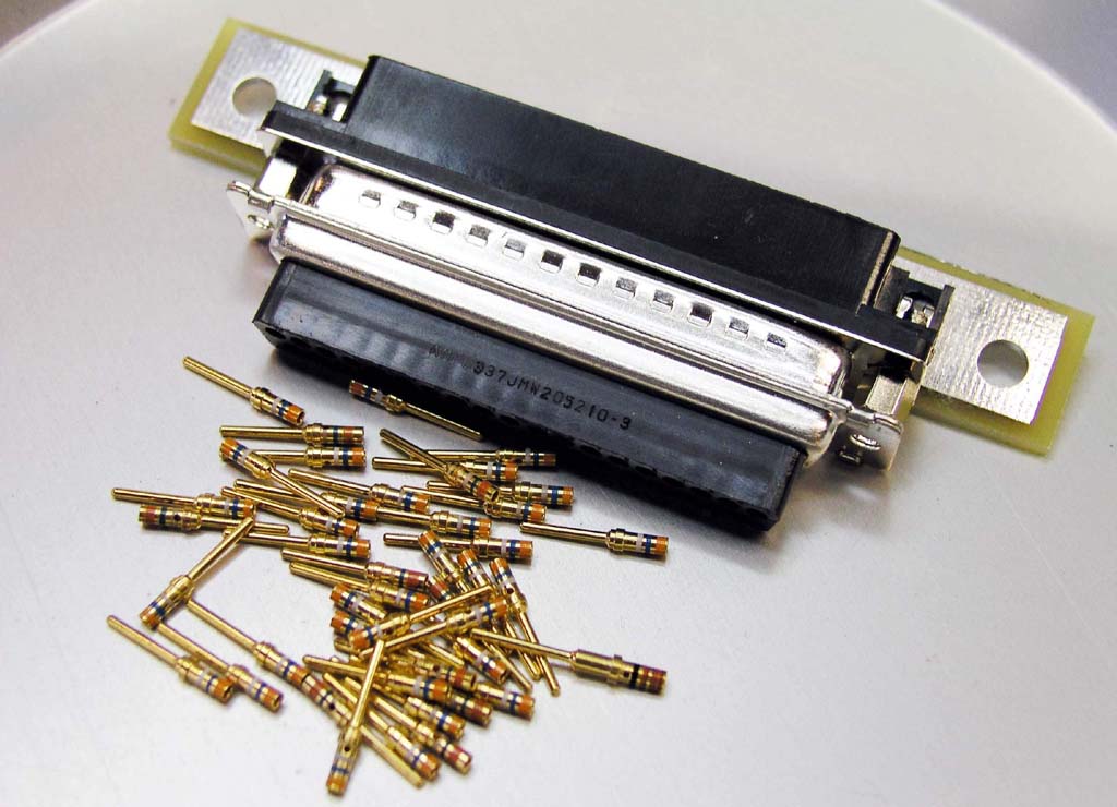

PostPosted: Sat Nov 05, 2022 11:01 am    Post subject: forest of tabs behind panel Reply with quote
At 08:05 PM 11/4/2022, you wrote:
--> AeroElectric-List message posted by: "N43YX" <awgaut(at)gmail.com>
Thanks, Bob. I'll check out that diagram.
if you'd like to do panel grounds using a d-sub
ground bus, I might have enough resitual inventory
around to craft one for you.
