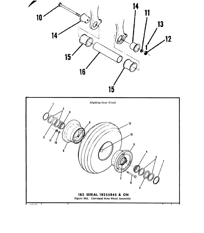

Glastar has this same issue. The difference is that they use a Cleveland wheel that has seals like the main axels. They use an aluminum spacer between the fork and the bearing (slipped over the axel) and then a small roll pin in the fork that seats into a small slot on the spacer to stop rotation.
With the radius on the bearing that we have the only solution is to have a spacer that has the same radius and a large surface area.
Another thing to try is to have a spacer inside the wheel on the axel so that when you clamp up the whole assembly the inner race of both bearings are clamped between the spacers and thus you can clamp the bearing race tight without preloading the bearing excessively.
All in all not a great design from Van.

I have attached a pic from the parts manual of the nose wheel and axle of a
C-182 for reference.
Kevin
