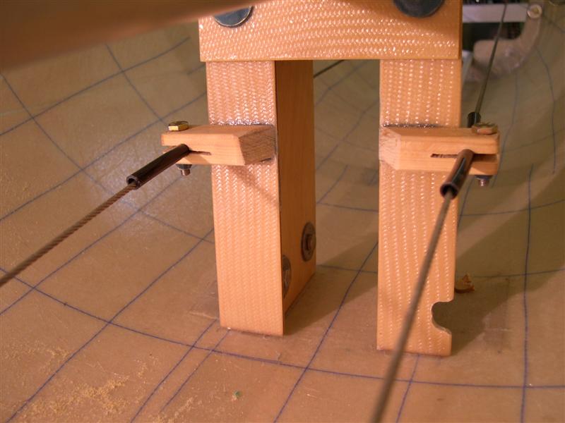

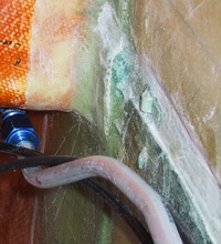

| Quote: | What is favorite way to adhere to baggage bay ribs? Going through fuse?
Ron,
Attached is what I did. The clamps in the baggage bay did not have their
bolts inserted at the time this photo was taken.
Note that I extended the black tubing back underneath the flap drive cross
tube because the cables just touch the tube when the flaps are down. I have
fitted Graham Singleton's tail wheel mod which elevates the cable at the
rear end more than the factory set-up.
Cheers
Kingsley in Oz.

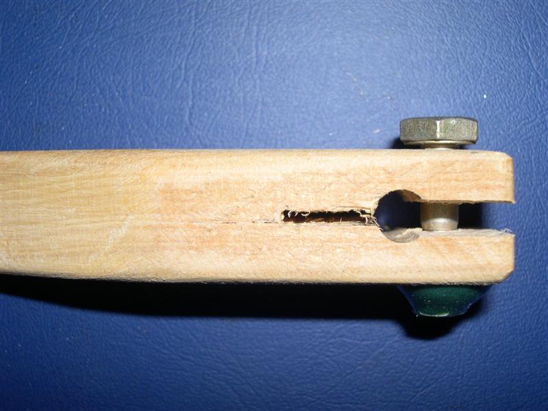

| | - The Matronics Europa-List Email Forum - | | | Use the List Feature Navigator to browse the many List utilities available such as the Email Subscriptions page, Archive Search & Download, 7-Day Browse, Chat, FAQ, Photoshare, and much more:
