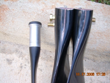

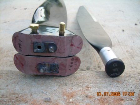

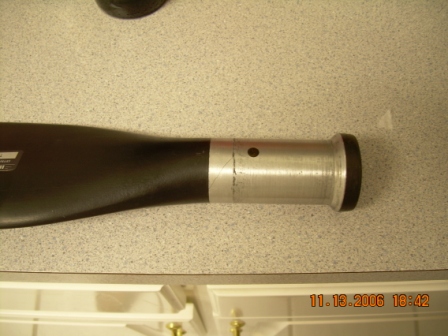

Thanks for all the input and suggestions. I will try to attach 4 pictures of the crack.
Travis

Thanks for the photos Travis. Boy, good thing you found those before they
got any worse!
Deke

lcfitt(at)sbcglobal.net Guest
Posted: Tue Nov 14, 2006 3:01 pm Post subject: Vixen: Warp Drive Cracked (Continental Engine) |
I remember this when it started. There was a guy at one of the Skyster
fly-ins with a crack in the aluminum - I don't remember what engine he was
running. I thought - and please correct me if I am wrong - that the
aluminum ring is non structural and serves to give a smooth metal interface
between the composite structure and the hub. I would be curious to know if
the crack is continuous with the composite blade or is limited to the
aluminum.
Lowell
| Back to top |
FlyboyTR
Joined: 04 Nov 2006 Posts: 215 Location: Mobile, Alabama
Posted: Tue Nov 14, 2006 3:32 pm Post subject: Re: Vixen: Warp Drive Cracked (Continental Engine) |
I'm not sure if it's continuous or not. It would be hard to tell without grinding the collar off.
Travis

Ivo Magnum arrived. Looks OK. Wanted to add a couple of pictures showing the Warp Drive and the Magnum. It looks really "large" as compaired to the Warp. Plan to install this week. I'll update after installation and flight testing.
Travis

At first I thought dang big blade, wide cord, longer, and then I saw it
is going on a continental. That looks about right to me. Hope it works
out. Interested in the real world results. Thanks for the pics. Love
that feature.
