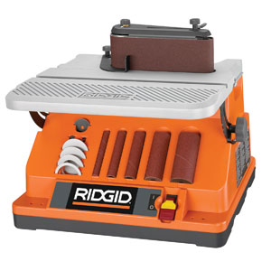

Bruno - Not sure if you can get one of these Ridgid sanders on the continent, but it is THE machine for scratch builders. I've made all of my forms on a 10" Craftsman bandsaw and this sander. It does the bevels and the crimp locations with ease.
Chris in Seattle
