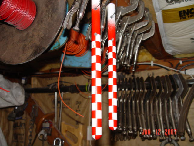

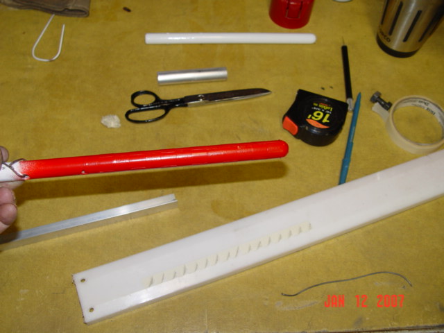

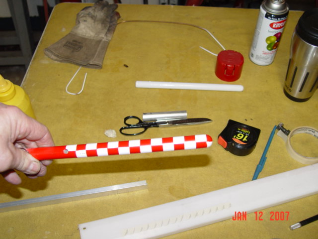

Hey Guys,
Got a few more days off ( Birthday ) so I've been goofin around
with the plane of course....Fix'n things and clean'n things up....
I needed to lengthen my Aileron counter balance rods , So I took them
off , Re Drilled and tapped a hole....Needed to repaint them , so
I figured I'd try somethin new....Here's some pictures
Gotta Fly...

Alot of work to these little guys...
Look, their even right & left....
Now "roll yer eyes" and say
Oh Brother!

planecrazzzy
PostPosted: Sat Jan 13, 2007 5:34 am    Post subject: Re: Little details.... Reply with quote
Just doing some "fine tuning"
I have aways had the counter balance rods on the ailerons...
But during "folding & unfolding" I noticed they weren't quite balanced...
The aileron was heavier....so I moved the rod out more....
I think the "old" gap seal affected it before ...
I've never had Flutter , and I hope I never do...
Gotta Fly...
Mike & "Jaz" in MN
