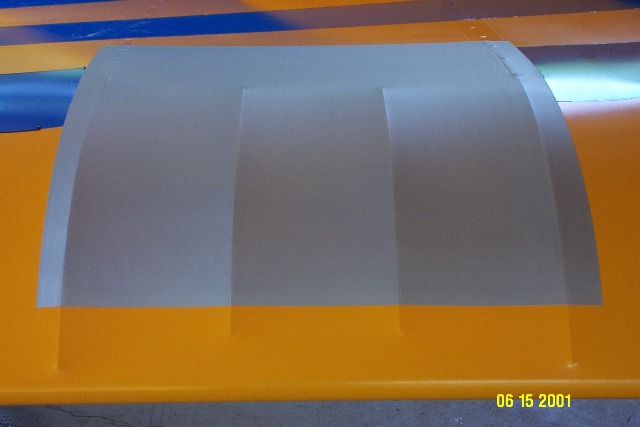

I did have a similar tear in the top of my Firestar wing. It wasn't from
cats, it was self induced. I had the plane folded and under the open end of
my shop when a summer thunderstorm came through. The tailwheel was on a
small 3 wheeled dolly and a wind gust caught the wings and pushed them into
a 4x4 support post. The result was ugly and made me sick. The repairs, per
the polyfiber manual, are not too noticeable. Will attach a pic or two.

John C:
You did a good job on the wing repair. Really looks good.
Super important area for proper patching. To lose a patch in that
area in flight would blow all the fabric off the wing.
_________________ John Hauck
Titus, Alabama |

Well that's reassuring.
I have a 243 and a 270 that should do the trick.....
Thanks for the info a pics... helps me to feel better....
Mike
