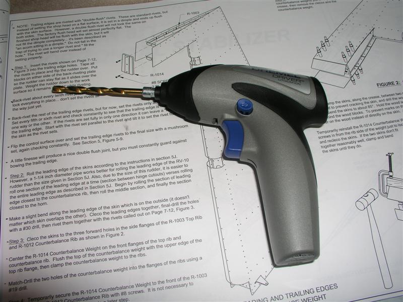

I picked up the coolest little tool a couple of days ago. I was deburring holes with a larger drill bit, spinning it by hand. I got a slight carpal tunnel, and my hand started to get numb very fast.
Went to Lowe's and picked up this Dremel Driver. It's small, fits in your hand, the max rpm in 300, and the trigger is very controllable. You just have to use a drill bit with a hex shank. Check out the attached picture.
Bought my toolkit from Isham (planetools) because it included the pneumatic squeezer and the DRDT-2. I have this big grin on my face every time I use the dimpler Smile
I also picked up a hand squeezer from Avery. It's more accurate and has more control than the pneumatic one.
