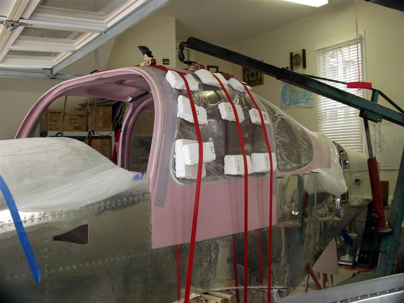

Door latch picture ... (Sorry, I couldn't resist!)
James, I agree about the micro switches -- if you play with the magnetic switches provided (ohm meter on the leads while you move the magnet around the sensor), there's really quite a wide range. I was resigned to adjusting it while installed to find a true closed reading, but I'd prefer micro switches.
Thanks, Tim -- the bevel only makes sense to pull the door in.
And I'm really not comfortable with a threaded joint anywhere near the shear point.
Later, - Lew

You have threads (plans call for a tap) there already; its just a question
of whether you fill them with something. The bevel is required but the
length of it is the question. Van's bevels range in size from .5" to '9".
