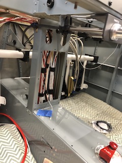

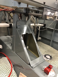

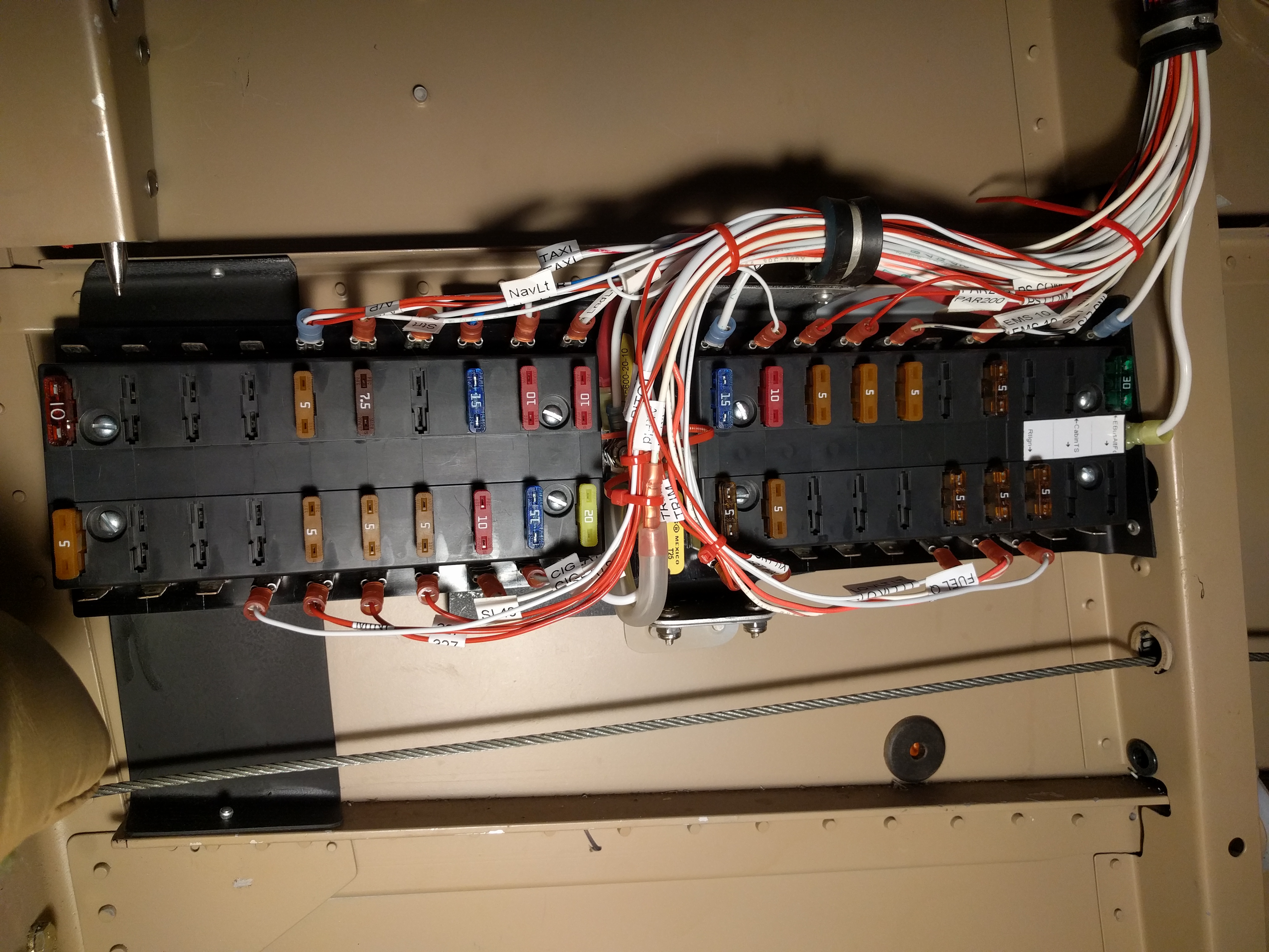

PostPosted: Sun Feb 19, 2023 6:46 am    Post subject: Re: Primary Power Diagram RV-14 Reply with quote
Since you guys have bullied me into using fuses:) , I'm looking at installation
ideas. I actually see some other benefits other than those mentioned.
The RV14 has an area in the fwd area of the center tunnel that most builders
use. Vans even has a kit that fits this area to allow the fuse/cb panel to
be angled so it is more accessible and easier to view. Also gives more space
behind the fuse/cb panel for wiring.
I will attempt to post a couple of pictures to show what I'm considering.
Also, I attached a link to a fuse block I found during initial research.
Sorry, pictures look like they are very large. I will try and re-size when I
a minute. T
As always, all critiques and ideas welcome.
