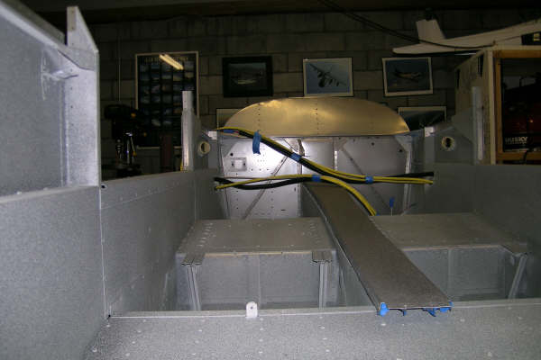

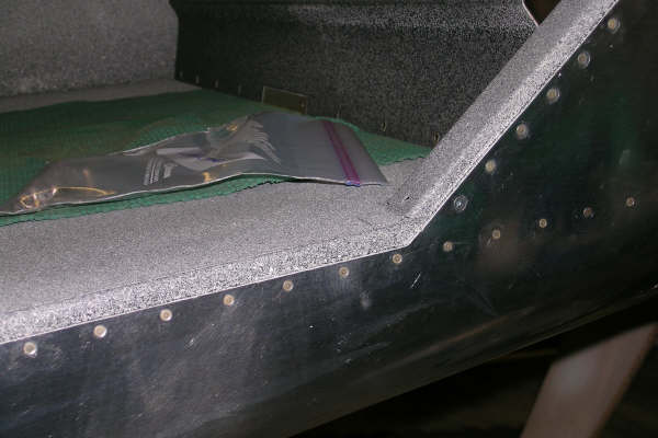

As for painting the interior, just want to let you all know that I painted
my interior with Zolatone using two different colors and the results were
quite nice. The tunnel cover, the aft wall and the roof will be a different
color than the rest.
My plane will be a fairly bare bones transport tool, but the results with
the paint are really clean and it should be very durable and stain proof.
Only cloth will be on the seats and the armrests.
John G. 409 Do Not Archive

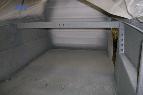

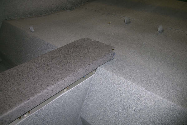

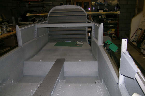

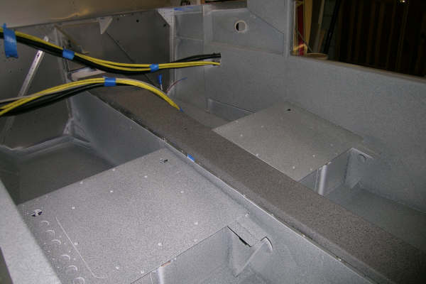

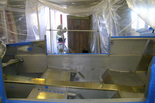

PostPosted: Thu Mar 29, 2007 6:42 am    Post subject: Interior paint! Reply with quote
HERE ARE SOME PHOTOS OF INTERIOR PAINT...ZOLATONE

PostPosted: Thu Mar 29, 2007 7:34 am    Post subject: Interior paint! Reply with quote
John,
Very nice results and much lighter than upholstered panels. A few
questions about the process.
1. What primer did you use under the Zolatone?
2. Did you over coat the Zolatone with clear polyurethane?
3. Have you pre-fitted the cabin top or does that come later?
4. Are you installing a headliner or using Zolatone on the cabin roof?
Vern Smith (#324 riveting fuselage skins)
indigoonlatigo(at)msn.com
PostPosted: Thu Mar 29, 2007 8:06 am    Post subject: Interior paint! Reply with quote
I used the primer that Aircraft spruce sells, but there is some confusion on
the directions on the Zolatone web site as far as what primer is used on
aluminum versus ferious metals. There are conflicting statements regarding
aluminum. Mine was a quick build fuselage and it appears that the Shermin
Williams primer was compartible with the zolatone because the Zolatone
overspray appears to have adherred quite well. I would test it without a
primer if you have been using the Sherwin William's product or have a Quick
build. Go to their web site for more information.
No overcoat is necessary, it will also make any future repairs very easy.
As you can see from the picture I did a real nice job of masking off the
areas that interact with the cabin top. It will be easy to spot shoot and
lapse in coverage. The cabin top has not been fitted.
The cabin top will be the same black color as the aft wall and tunnel cover.
It is cool because it looks like fabric in that it is textured.
Hope it give some people some options to think about.
John G.

PostPosted: Thu Mar 29, 2007 1:26 pm    Post subject: Interior paint! Reply with quote
Go to the Zolatone web site and they tell you to use a Binks 2001, with a
big tip on it. I don't recal the number because I could not locate one
easily so I used a gun which shoot ceramic glaze.
John

rvbuilder(at)sausen.net
PostPosted: Fri Mar 30, 2007 8:50 am    Post subject: Interior paint! Reply with quote
This stuff has been around for a while and is popular on some of the moldless composites like the Long because of its ability to hide inconsistencies. Details on spray equipment and prep is here:
http://www.zolatoneaim.com/spray.html
Michael Sausen
-10 #352 Limbo
Vern(at)teclabsinc.com
PostPosted: Fri Mar 30, 2007 9:27 am    Post subject: Interior paint! Reply with quote
Michael,
Thanks for the link. I was hoping there was an alternative to buying a
pressure feed spray gun and pot. Though it would be nice to have one.
Vern (#324)
PostPosted: Fri Mar 30, 2007 10:04 am    Post subject: Interior paint! Reply with quote
For a single use application like this you might want to check Harbor Freight or others el cheapo's. Surprisingly, several of their guns are quiet good including at least one of their pressure feeds. Make sure you are getting a big tip though, that's the key. Zolatone wants something in the .020 size which is quite large.
Michael
rv10builder(at)verizon.ne
PostPosted: Fri Mar 30, 2007 10:37 am    Post subject: Interior paint! Reply with quote
On sale right now for $9.99 at HF #43430
I'll be doing my own testing today as I bought it earlier this week-
http://purplesagetradingpost.com/sumner/techinfo/HVLPspraygun.html
PostPosted: Fri Mar 30, 2007 10:58 am    Post subject: Interior paint! Reply with quote
You're absolutely right, there's no reason to spring for a high quality
setup. Something, with the right nozzle size from Harbor Freight will do
just fine. Thanks for the tip.
Vern (#324)
