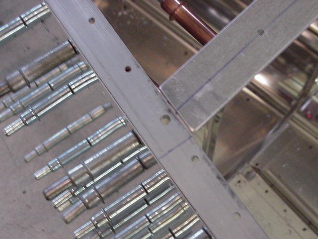

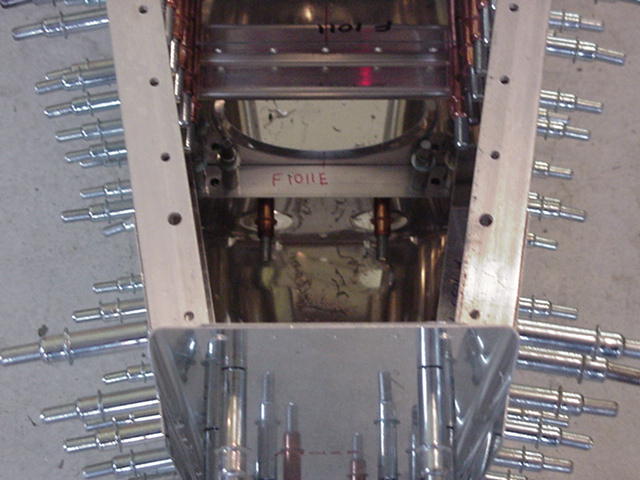

On page 10-13 steps 4, 6, and 7 we are instructed to drill the end holes of each piece to #12's into the longerons.  What is the proper, or acceptable hole clearances (to the edge of the longerons)???  Mine range from 1/4" to 1/8 inch on the closest ones.  Is this an acceptable distance or do I need to get new longerons and start over???
Pictures are attached.

Without measuring, yours look similar to mine, so it looks like we both followed as per plans.  You’ll be putting bolts in those #12 holes.
Rob
