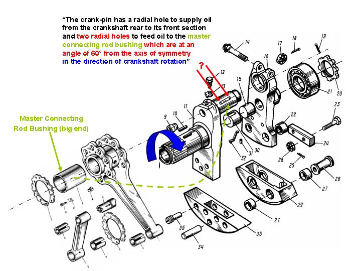

FYI - extracted the following master connecting rod lubrication description from the M14P manual ...
“The crank-pin has a radial hole to supply oil from the crankshaft rear to its front section and two radial holes to feed oil to the master connecting rod bushing which are at an angle of 60° from the axis of symmetry in the direction of crankshaft rotation”
... and compiled the attached JPG file composite of the associated schematic diagrams from the same source (which won't be distributed with the daily digest email but can be found at ... http://forums.matronics.com/viewtopic.php?t=43148 )
I'll leave it to the engineers amongst you to determine the significance of this description.

PostPosted: Mon May 05, 2008 1:05 pm    Post subject: "Over Square, back loading, detuning, underboost-etc. Reply with quote
Jim, just a comment. I am not disagreeing with anything you have said
or the quotes from others with far more round engine time than my own.
That said, the M-14 has been flying in Unlimited Aerobatic Competition
for years. I happen to have the privilege of working with (and on) the
M-14 engines mounted in a few of the most heavily and most outrageously
flown aircraft in this country. In most every M-14 engine I have had
experience with, the failure items usually consist of front engine seals
(gone bad from extreme loading in gyroscopic maneuvers... Looks like a
prop seal, but isn't!) some cracked piston rings, a lot of #2 cylinder
low compression gripes, many mag gripes, bent rods from oil in the
cylinders, but not one ... Not one single occasion of bad internal
bearings or any kind of silver in the screens. These engines are
usually flown with two power settings. WFO, and yanked to zero. The
only "normal" engine use is flying to and from the locations of the
competitions or air shows. Possibly we are not into the range of total
operating hours to see this kind of wear and failure yet? Most of the
aerobatic guys I know change engines at around 1000 hours even if they
are running OK.
Point is, I understand and concur with every word you have said, and
like yourself, I am wondering if there is anything different or special
about the M-14, because it sure is not failing like the American made
round engines would if treated the same way. Further, I believe that
the M-14 weighs less than any other American made engine for the
horsepower it produces. It is also 'geared' and turns higher RPM than
most made American Radials too.
I believe someone ought to contact Russian Master Mechanic Vladimir
Yastremski and ask him about this issue. I honestly believe he would
know even more than Jill or George about the matter.
Just a thought.
Mark Bitterlich
