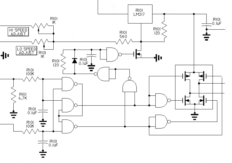

PostPosted: Thu Mar 08, 2012 12:35 pm    Post subject: Coolie Hat Switch Reply with quote
At 03:39 PM 3/7/2012, you wrote:
I'll second that. I have some "delicate" switches that would benefit.
Now you dun it . . . got started on a good idea
last night and couldn't put it down until after 2
a.m.
Here's a first pass at an all solid state, two channel
relay deck and trim speed controller for a pair of
Ray-Allen trim actuators. It features adjustable
rates for both pitch and roll trim, dual inputs from
pilot and copilot stick grips, conflicting command
lockout, 10 to 30 volt input so it can be used on both
14 and 28v systems, AND . . . it will only load the
trim-switch contacts very lightly . . . about 20 mA.
http://www.aeroelectric.com/Misc/7299_Ray-Allen_Relay-Deck_Schematic.pdf
The parts values are not assigned yet so don't run
of an start buying parts. This is a preliminary look
at one concept for integrating those $22 switches
from Digikey into a Ray-Allen trim system.
I know it looks 'busy' . . . and not everyone will
want a full-up system. But the added expense of
including provisions for unneeded features is trivial.
The builder can take an assembly like this and craft
any one of many combinations of features.
At first blush, it looks like it would assemble onto
a 2.5 x 2.0 inch ECB with a 25 pin d-sub connector down
one side.
I need to quit 'playing' and get back on some committed
activities. I've got a young fellow who is interested
in learning how to lay out etched circuit boards. I'll
email him a copy of the drawing and see if he can get
all the parts on that size board. I know I can but
we'll give him a something to do over the up coming
spring break.

PostPosted: Thu Mar 08, 2012 12:58 pm    Post subject: Coolie Hat Switch Reply with quote
wow looks great Bob!

PostPosted: Fri Mar 09, 2012 7:18 am    Post subject: Coolie Hat Switch Reply with quote
At a quick glance there appears to be a slight error in the circuit as
posted. (possibly a result of that 2:00AM thing?) It appears that the "up"
and "down" functions on the input switches control both the pitch and roll

PostPosted: Tue Mar 13, 2012 11:23 am    Post subject: Coolie Hat Switch Reply with quote
Re: on limit timer
I've been trying to figure out a way to add on-limit timer to the
previous iteration of the circuit but with a minimum of added parts.
Here's one pass at it:
There were three, 'left over' gates in the CD4093 devices which
I've combined with a capacitor, transistor, resistor and diode
to sense the presence of any input command. This starts a timer
set with the RC time constant of the resistor and capacitor
which will drive the gate of the transistor HI after n-seconds.
The transistor pulls down on the power supply's adjust node and
reduces voltage to the trim system to 1.25 volts. If the
motor will definitely not run at any speed under any load at
this voltage, then this shutdown philosophy would work.
Anybody got a Ray-Allen actuator laying around? Hook an
AA cell to the white leads and tell us what you see. The
next best alternative takes 1 more gate and a few more
jelly-bean parts . . . but it goes in series with the command
leads to the h-bridge.
[img]cid:7.1.0.9.0.20120313140559.01dfe710(at)aeroelectric.com.0[/img]
