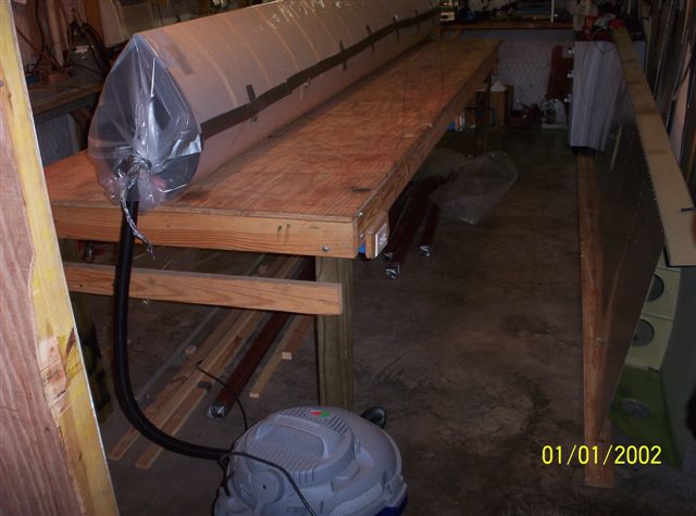

I got one nose skin bent today. Using the vacuum method it went well. I ran out of time (had to go to a Super Bowl party) before I finished the second one. I used steel pipe, which I had to join because the longest lengths I could find were 10 feet.
THere are pictures on my web site at:
http://daniel.dempseyfamily.us/zodiac/index.html

Looking good Dan, hope your team won. Did ya get any pictures with the vacuum applied and the part totally collapsed?

I t does not look as though you drilled holes in the pipe? I drilled holes along one side down the pipes length for the stab and elevator skins. I assume that you let the vac suck out one end inside the plastic? This is interesting, because I don't want to ruin another pipe by drilling holes in it when I do my wing skin!
Kevin

No I didn't. I picked up the camera to shoot one, but just about the time I was ready to take the picture a hole developed in the plastic and let the air out. The part was already bent, so I saw no use in fixing the hole just for a picture. I'll try again next time, maybe ask for an assistant on that issue.
Dan

I may drill holes for the next one. The pipe has already been claimed for a couple of closet rods, so a few holes won't matter. I had a very thin wall piece of brass pipe from a sink drain in a pile of junk and I took that and crushed one end in the vice. This became my "nozzle" which I fastened to the end of the vacuum cleaner hose. It worked OK but was hard to tape in place.
One thing I'm not certain about is whether I'll regret not drilling the rivet holes before bending. Has anyone done it that way? I'm going to have to lay all my holes out on a now curved surface.
Dan

Posted: Mon Feb 02, 2009 10:18 am Post subject: Pipe for bending leading edge |
Dan, you mean "two flat surfaces with a narrow curved surface in between"...
Carlos
2009/2/2 leinad <leinad(at)hughes.net (leinad(at)hughes.net)>
[quote]--> Zenith-List message posted by: "leinad" <leinad(at)hughes.net (leinad(at)hughes.net)>
Dan[b]

naumuk(at)windstream.net Guest
Posted: Mon Feb 02, 2009 3:28 pm Post subject: Pipe for bending leading edge |
Dan-
No, you can lay out your holes on a flat surface. Use a piece of scrap
sheet and drill your holes in it, then duct tape the stock to your nose skin
and transfer using a Sharpie. I believe Larry Mac's site has pictures. For
an XL, compared to the tapered wing of an HDS, this should be a snap.
Bill
